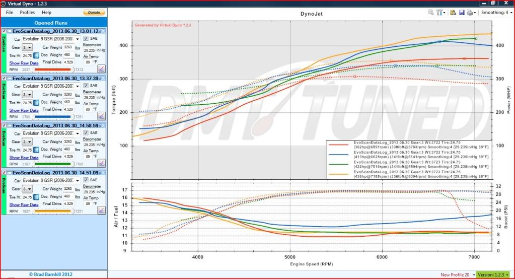

I'm on stock cams, exhaust mani, and tb for now. Also this is on pump gas.
I have the td06 25g, billet wheel, 10.5, light port and polish.
Old Jul 5, 2013 | 12:27 PM

Tom, your car on SD or MAF? if MAF, how much airflow?
Old Jul 5, 2013 | 01:49 PM
  #552
WikdEvo's Avatar
Joined: Sep 2012
Posts: 604
From: Des Moines, IA
Sd

recorded the last several logs with preload adjuster +5 full 360" from zero preload, just to make sure... i think, my turbo maxed out. There is no big difference if preload adjuester fully screwed or not. max airflow 350 g/s.
guys, when you buy your turbo? i'm in sep 2012. maybe i have some old version of billet wheel or smth like this
