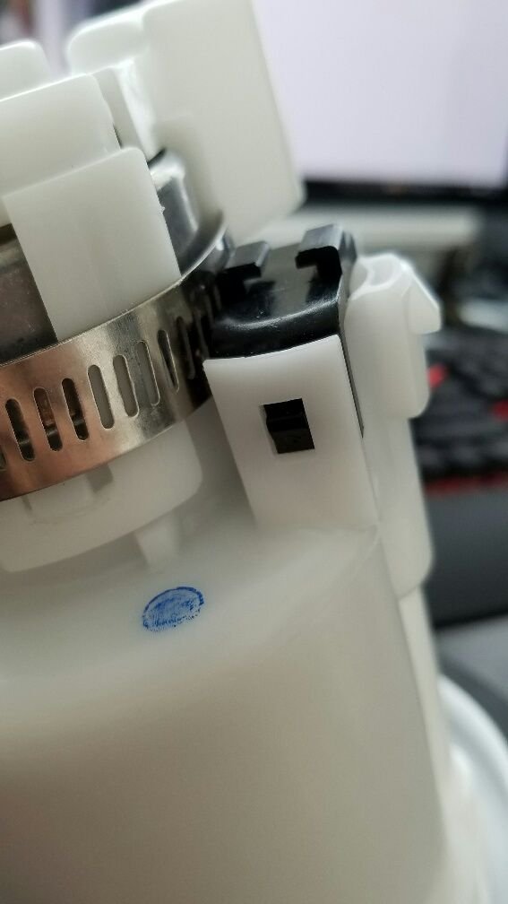

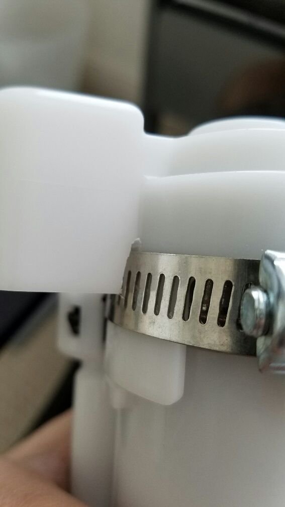

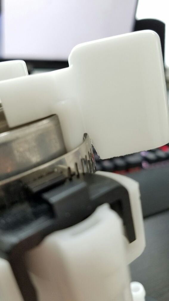

Is it just me or is everybody leaving out the part where you have to modify the lower fuel pump bracket to fit the damn thing? You also need to slice some clearance the for ring worm clamp to fit properly.
-pal215
Old May 8, 2016 | 03:37 PM
  #236
honda-guy's Avatar
iTrader: (55)
Joined: May 2005
Posts: 3,589
Likes: 37
From: Central PA
Yup. i had to do that.
Old May 8, 2016 | 04:06 PM
  #237
Ude Lose's Avatar
Joined: Nov 2011
Posts: 269
From: NY
Yeah me too...
