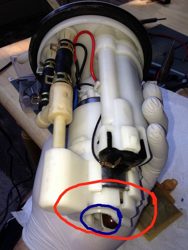

I did leave out that i drilled my siphon out. I can't recall the bit size I used but iirc it was 9/64. I don't have a fuel pressure gauge either sink can't give readings just yet. I will have one installed in about a week and can report back if anyone is interested.
Even with the siphon drilled as described, if that pump is getting full voltage, it should overrun the factory return line. I would be more concerned if it weren't.
On the flip side, the factory feed line creates considerable friction losses, which are exacerbated with the ~30% increased demand of E85. There is a good probability that is starving the rail of pressure at 600+whp, but the pump is working much harder regardless due to the pumping losses through the line.
Make a way to check the FP at idle and at full load, and check pump voltage at full load, but the tiny OE lines are undersized for this application. I strongly advise upgrading them.

yes i have. i drilled the syphon as well. i also made a true 6AN return setup for it so there was no backup/bottle neck affect. the feed's go from 6AN to a (WYE) to single 8AN to the rail. then to a FPR and full 6AN return. works awesome.

followed this and it works great just remember to drill the siphon

Where do you buy the fittings and what is the siphon?
