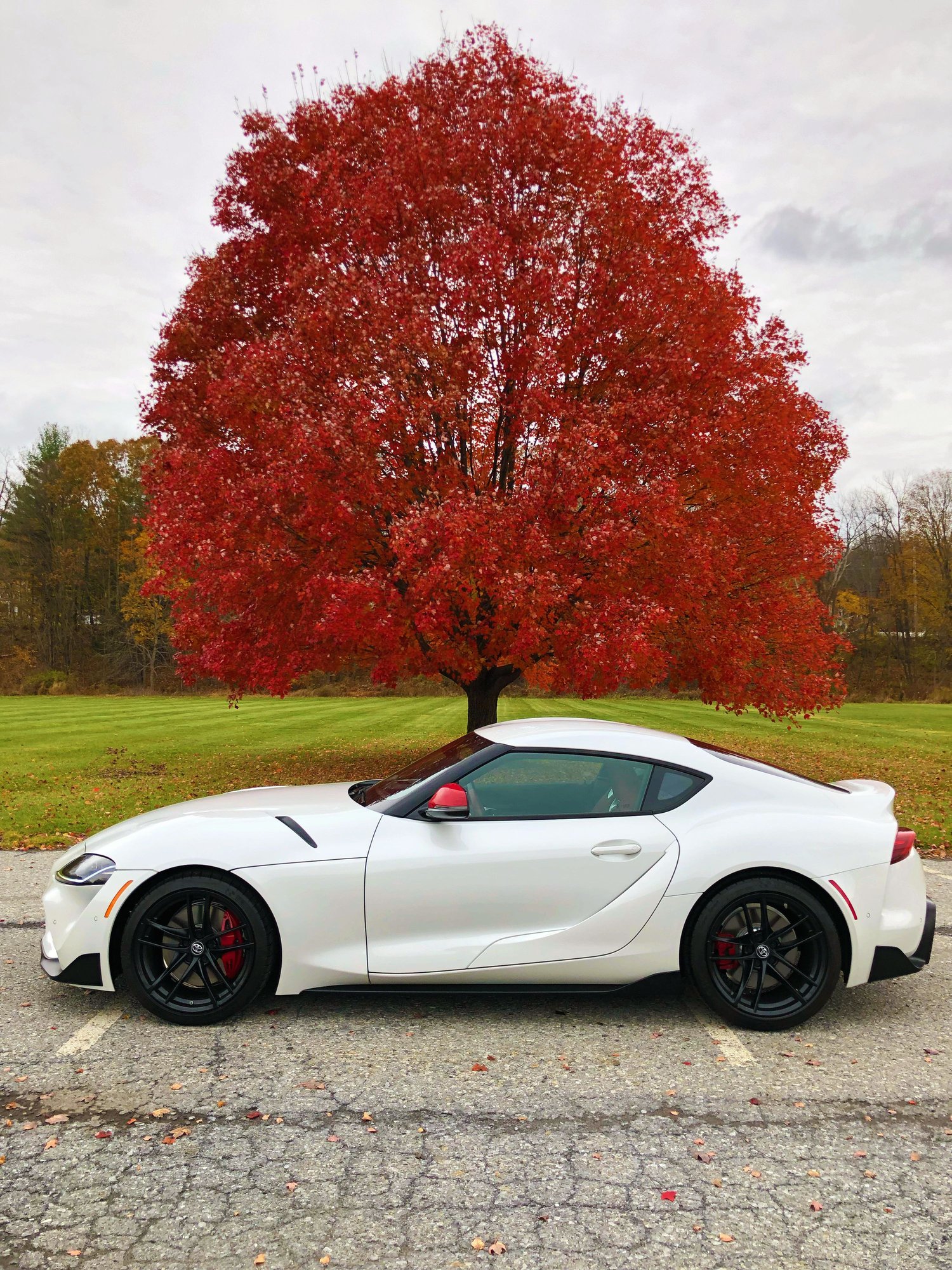

My Supra has arrived! Of course, I wasted no time with the ECU...

Very nice! Please tell me you took it out and tore up the roads before you bumped the boost up.

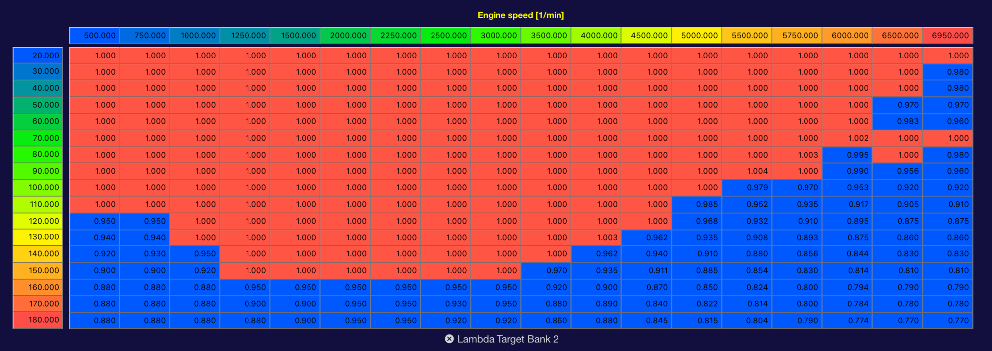

Edit - can you answer a question for me since you can read out the ecu? Do you see anything that says to run a 14.5 afr in 1-3rd gear (under full load) then richen up as you keep shifting?

I didn't flash it yet. I was just licensing the ECU so I could look at all the fun tuning tables.
Yup, most modern DI cars run stoich in boost and under WOT. They have enrichment after time based on catalyst and EGT temp. So you will find the car starts richening up the longer you are in WOT.
I took a look at the target WOT lambda tables and they do target 1.0 lambda until higher rpm where they have slightly richer targets. Then of course, if you are in WOT for longer, the enrichment starts happening overall.
Here are the two target tables:

Perfect! Thank you. That is exactly the info I was looking for. Cant wait for that software to work on my car....
